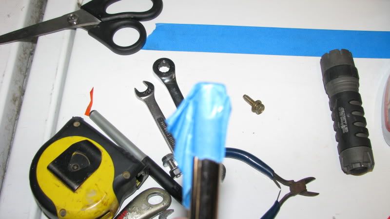

Tools needed.
3/8” ratchet
5/8” or 16mm spark plug socket
10mm socket
6” extension
2” extension
Anti-seize
Dielectric grease
Torque wrench

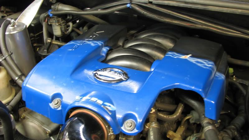

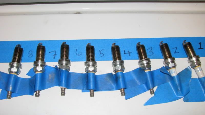

I changed them out in cylinder order. The hardest where #7 and #8 which are the farthest back. I did not need a swivel as some have said for #8…

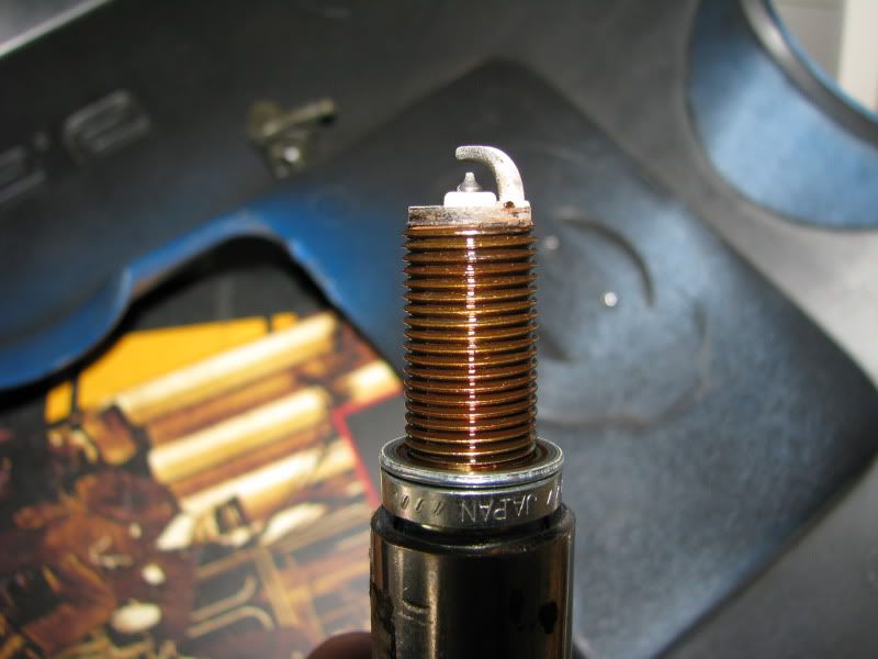

Plug #1
Remove plug. They were not that tight. I suppose Nissan’s 800 lb gorilla had the day off when my truck was built. <img src='http://www.titanspot.com/Titan/public/style_emoticons/<#EMO_DIR#>/003.gif' class='bbc_emoticon' alt=':smt004' />
#1 plug
Before installing the new plug put dielectric grease on the top of the plug and anti-seize on the threads.
Thread plug in by hand gently so as not to cross thread it. Get it finger tight then torque to 18 ft lbs…

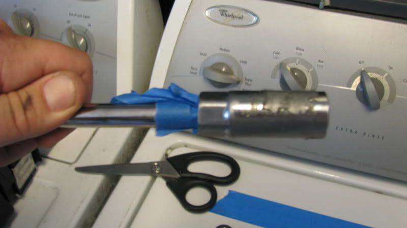

After torquing the plug I could not get the socket off the plug without the extension pulling out thus leaving the socket down in the well. My solution was to put masking tape on the extension then putting the socket on and proceed to torque them down. The tape made the socket very tight on the extension.

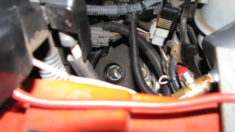

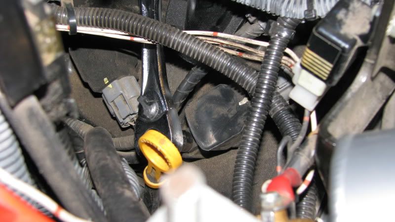

For access to plugs 6 and 8 you will need to unbolt this wire harness bracket and twist it upward. Plugs 6, 7, and 8 required both 6” extension and 2” combined…
#7 plug

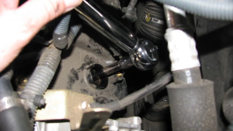

Removing #8. The hardest one to get too…

Done…..
Engine idles much smoother. I will check mileage soon. Hope I didn’t forget any details.. <img src='http://www.titanspot.com/Titan/public/style_emoticons/<#EMO_DIR#>/004.gif' class='bbc_emoticon' alt=':smt006' />

The burn wear looks "NORMAL" like mine with over 80K on them but there is definately a change in "feel"... <img src='http://www.titanspot.com/Titan/public/style_emoticons/<#EMO_DIR#>/020.gif' class='bbc_emoticon' alt=':smt018' />
They might last 100+K but at 40-50K if they are half way gone I think it's a good practice to replace them and see how the cylinders are doing.

Wow, all those extensions and swivels? Hmmmm... Ya the plug by the master cylider was ok to get to but when it came time to remove my extension would hit that thing. Took some manuevering to get it out. New plugs sure makes a difference dont it? <img src='http://www.titanspot.com/Titan/public/style_emoticons/<#EMO_DIR#>/003.gif' class='bbc_emoticon' alt=':smt017' />

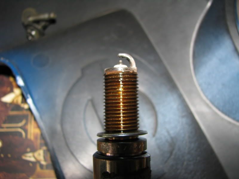

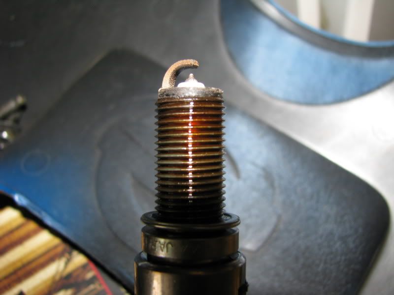

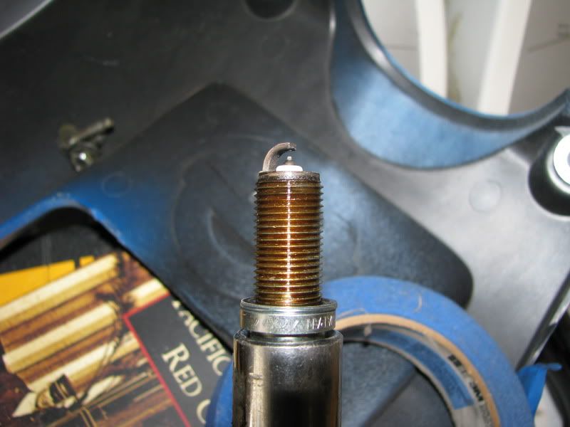

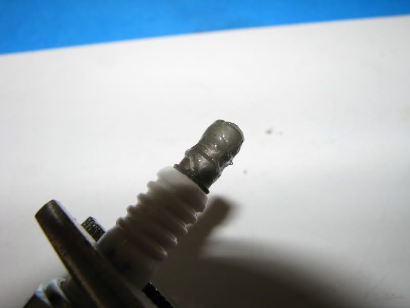

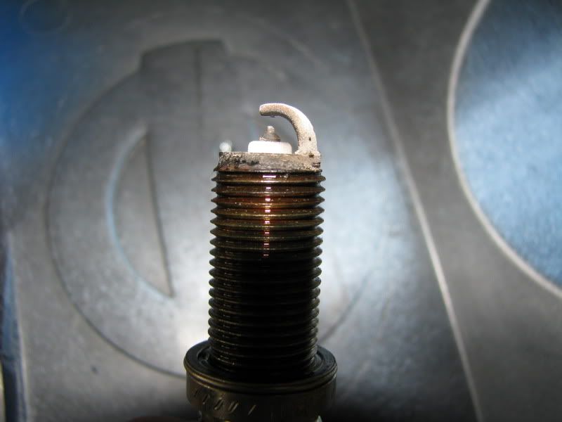

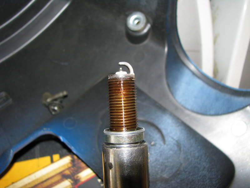

Upon further inspection of the plugs, two things I'm not happy about. The first is ... another Nissan design flaw, IMO. The gaskets at the coil packs are not water proof. Note the muddy water stains on three of the plugs in the first two pics. Nissan should know better, at least on their Off road version of the Titan. They have years of experience with the Nissan Patrol after all.
The second is the look of one of the plugs that seems to have oil on the lower threads, while the part near the top seems cleaner than the others. It can be seen in the last three pics. Btw, the pics make them look worse than they do it person, even the worst one look fairly good st the electrodes.
The second is the look of one of the plugs that seems to have oil on the lower threads, while the part near the top seems cleaner than the others. It can be seen in the last three pics. Btw, the pics make them look worse than they do it person, even the worst one look fairly good st the electrodes. [/quote]
Pulling/replacing the plugs tells a story.........that story to me is worth the cost of replacement way before 100K. Looking at your sig pic. makes me wonder how much mud is sitting in the valley where the starter is located?... <img src='http://www.titanspot.com/Titan/public/style_emoticons/<#EMO_DIR#>/009.gif' class='bbc_emoticon' alt=':smt009' />
I would "keep" my eye on the plug with oil on it and see if it's still happening.......hope not!

[quote name='swarren1' date='14 September 2009 - 01:53 AM' timestamp='1252907601' post='152862']
Mine looked very simailar to yours. Slightly oily on the first 4 or 5 threads then dry as a bone.
