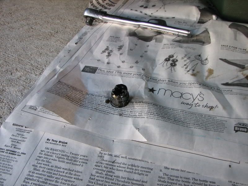

Lower plug with “stuff” on it.

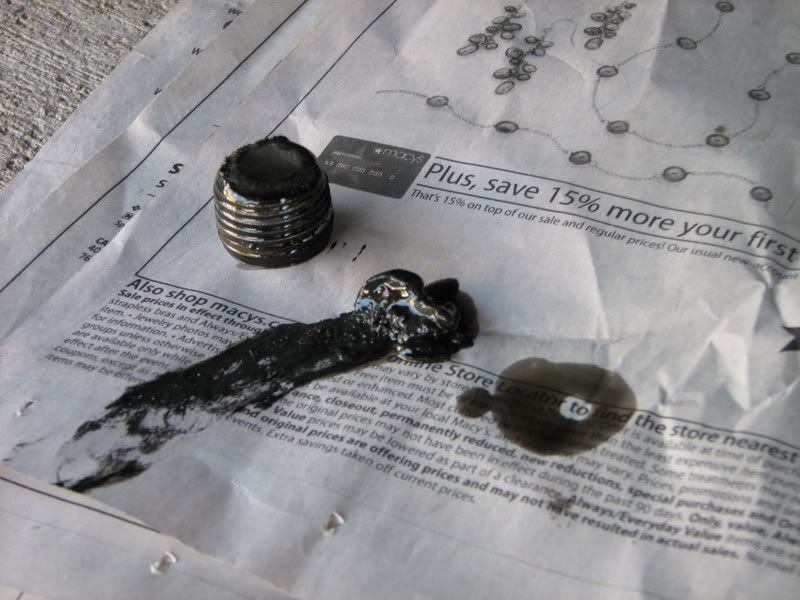

Stuff

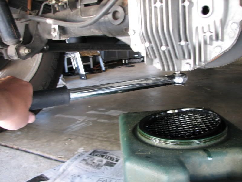

Torque plugs to 25 ft-lbs.
