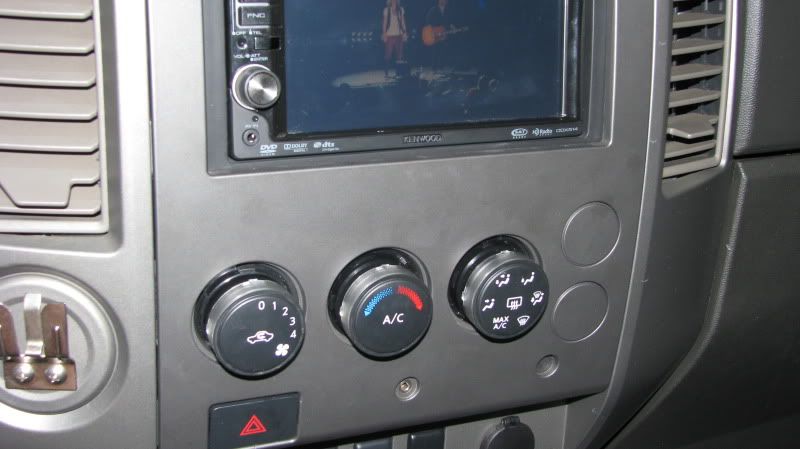

Well my control knobs were showing 6 years of wear so I decided to paint them.. They should have come black from the factory IMO.
Used 400 grit sandpaper, Krylon Flat black, and Krylon Flat "clear" coat to finish.. I like it.. <img src='http://www.titanspot.com/Titan/public/style_emoticons/<#EMO_DIR#>/001.gif' class='bbc_emoticon' alt=':smt023' />

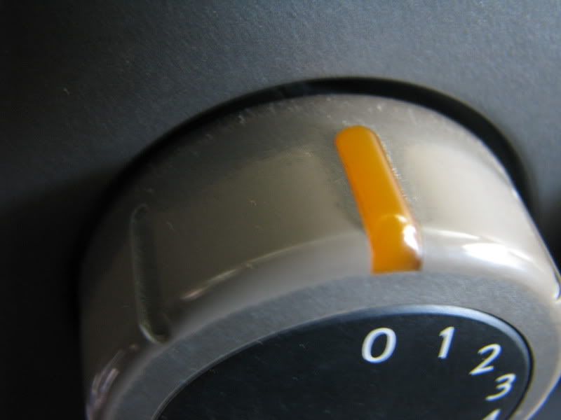

Worn knobs........

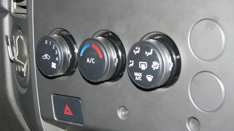

Done....

I didnt paint the centers, I just painted the outer rings to match the centers.. You just pull off the outer rings, sand, mask, paint, clear coat, then clear coat again.
